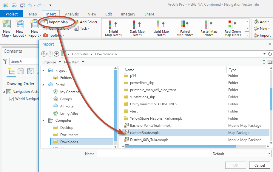

MarkBockenhauer
Amelia,
Open a New Project
On the Insert tab, click Import Map and then you will see .mpkx files (maps) in the browse dialog.

AmeliaNewsam
Thanks Mark!
LeilaniFitzgerald
I'm having the same issue and am wondering if there is a second option? I've tried it the way Mark has shown and my file still doesn't show up. Even after ensuring that I've selected "Map Packages" from the drop down menu. Thanks in advance.
