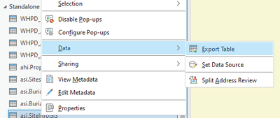

Thanks @SSWoodward. Sure thing. I right click on the SQL view in my ArcGIS Pro contents list and Data - Export Table.
Or I use the Export Table from the geoprocessing pane - should be the same tool.
I export it to the project gdb.
When I look at the new exported table, the field that was the unique identifier is not there - it's replaced with Esri's OBJECTID.

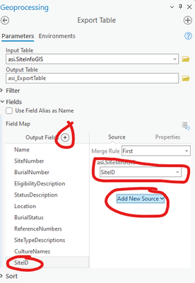

In any case, I tried the Field Map in the https://pro.arcgis.com/en/pro-app/latest/tool-reference/conversion/export-table.htm Export Table tool, thinking this would be great. Well I got the field but it's all Null. Here's my window of how I set it up. I hit the plus button to add a field I called SiteID, then I hit Add New Source and found the SiteID field in the SQL view.
Here's my exported table all Null
