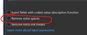

The first thing I'd check is whether those spaces are actually printing in the label.  In the Label Class pane, there's a checkbox to remove extra spaces.  Make sure it's unchecked, and see if you're still having this problem.
