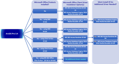

It might be worth double-checking the Drivers you have installed, or may need to install.
https://pro.arcgis.com/en/pro-app/latest/help/data/excel/prepare-to-work-with-excel-in-arcgis-pro.ht...
JoeyAbalos
I did install the following MS Access Datable Engine 2016 Redistributable 64-bit driver and both .NET Desktop Runtime 32/64 bit. I still get the error message.
