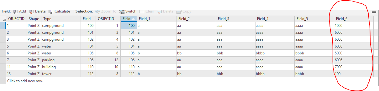

I have a feature layer that I am joining a table to. The table has multiple records that match some of the features in the feature layer; so when I perform the join there are duplicate features that have different attributes from the joined table.
When I use a definition query (on a field in the joined table) to get a subset of the feature class it doesn't always take the matching table attribute data; it sometimes uses the attribute data for a records that does not fit the definition query.
Here is my example:
The definition query is for all features where Field 6 equals 6006; but for some of the features with multiple records in the table it is not taking the record that fits the query.
I have tried duplicating this in ArcMap and do not have this same problem. All features match the definition query.
Is there a fix for this?

1:M join in ArcGIS Pro (FC:Table). After creating the join, apply a definition query.
Problem: The definition query isn't being applied properly; there are incorrect values being displayed in the attribute table.
Best guess at what’s happening: There are n rows in the join table that match the ID from the input table. In this case, there are two matching rows. It’s not getting the correct matching rows; it’s getting the first two matching rows, but not honoring the criteria in the definition query.
The issue happens in an Oracle EGDB and in a FGDB in ArcGIS Pro 2.6.8.
Support:
We tested the same workflow on a laptop with ArcGIS Pro 2.6.8, we were able to reproduce the issue exactly the way it was in your video.
The issue is resolved in ArcGIS Pro 3.1x
