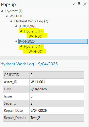

Hello,
I am having an issue where the pop-up keeps repeating.
I used relate tool to connect the table - Hydrant work log to the feature class layer which has been successful but it has repeated the popups.
How do i remove the ones in yellow?

AlfredBaldenweck
MVP Frequent Contributor
I think that's just by design. The popup shows all features related to the given feature, as far down as they go.
I don't think it's smart enough to recognize that it's redundant.

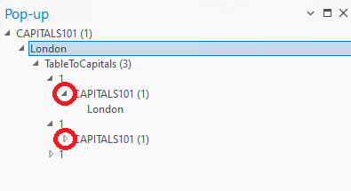

ChrisUnderwood
Hello @Darshan_Neupane , you can use the little arrows to hide those details. Is that what you mean ?
Darshan_Neupane
Hi @ChrisUnderwood , I wanted to know if it was possible to remove or disable the arrows from expanding.

Darshan_Neupane
Hi @AlfredBaldenweck , So it cannot be removed or be disabled from expanding?
