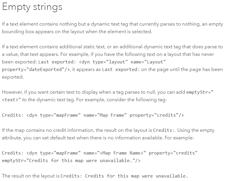

Hi,
When working on my map series, I tried to add dynamic text.
1) I selected the correct field from the table I wanted.
2) I formated the text so the viewer can see what the value is refering to:
3) My problem now is : even when there is no value to the field, the title appears:
How could I do something like: if there is no value, don't show?

Hi Marie-Joëlle,
I've copied the relevant portion of the topic Dynamic text tags that should help you.
Hope this helps,
Tom
