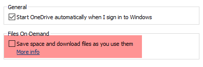

George_Thompson
Esri Notable Contributor
Do you have the following setting checked in OneDrive?
It could have been updated then set by your Org at the admin level.
--- George T.
KenTice
I had the same issue and unchecking that "Save space and download files as you use them" solved the issue.  This fixed it even though I originally unzipped the files to my computer.
