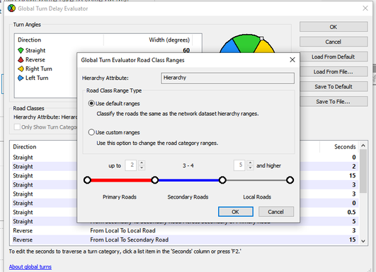

When using ArcMap we had selected use default ranges

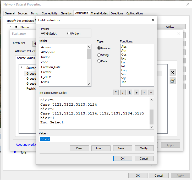

And in field evaluators there was a vbscript used by hierarchy
With ArcGIS PRo the issue was with a constant value 0, we changed that to 3 and it worked. We didnt manage to do that through ArcMap so we had to use ArcGIS Pro, we built the network dataset there and the issue was solved.
