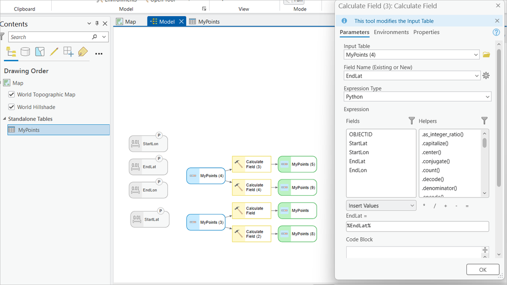

I added the elements you suggested. I made a template standalone table on my project with two rows, one for start and one for end. Then made two double (numeric) fields that can contain my Lat and Long.
I have the flow set up as below;

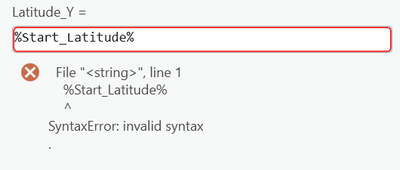

The calculate field didn't run when I contained the variable parameter in '%'. I was getting the following error;
File "<string>", line 1 %Start_Latitude% ^ SyntaxError: invalid syntax
When you connect the variable parameter to the calculate field it has the options expression or precondition. Should I connect it like that?
BobBooth1
Is your variable name Start Latitude or Start_Latitude? The spelling in the calculate expression must match the variable name.
What is the data type of the variable? The syntax %Start_Latitude% syntax should be correct.
https://doc.esri.com/en/arcgis-pro/latest/help/analysis/geoprocessing/modelbuilder/inline-variable-s...
You don't need to connect the variables to the Calculate Field tool, just use the exact name, wrapped in % in the expression box.
You could set it as a precondition, I suppose. Preconditions are a way of ensuring that a given part of a model has run before another part runs.

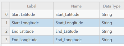

KevinColtart
Thanks so much for your replies, this has been giving me a real headache.
The label for the variable is 'Start Latitude' but the name is 'Start_Latitude', which is the one I used.
When I try to reference with the % I get the below syntax error.
I suspect that it is related to the formatting of the variable and input. Both my variable and my template table fields I am trying to update are set to double.
I see the point about preconditions. These won't be needed in this model as it will only start once the variable are input into the tool by the user.
BobBooth1
Try %Start Latitude% - that's what your image of the model shows.

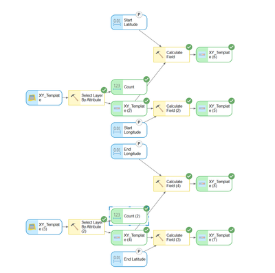

I have tried a bunch of variations with no luck. Here are the properties;

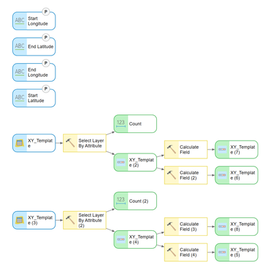

I changed the variables to String and they works but only the first field and only once..
The whole model looks like this now. The fields within my template table are <Null>, could it be that blocking the update?

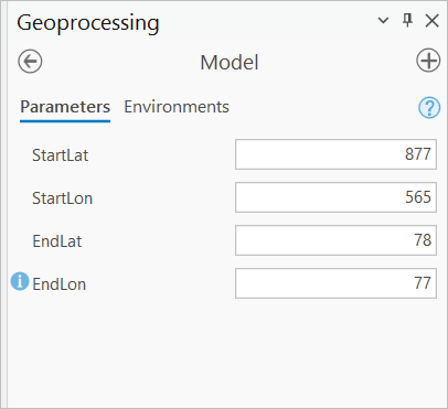

If the values in your calculation are supposed to be coordinates, as Doubles, I'd suggest making the parameters Double too.
Here is my version, for your inspection.
KevinColtart
Fixing the format has made it work! Not sure what I corrected on the Field calculation tool to make it work. I think learning that you don't need to connect the field parameters to the tools was the curve ball I needed to learn. Being able to reference the variable parameters with the %, despite the validity checker within the field calculation tool saying there is an error. The string error was still there despite it working now.
Thanks very much for the help on this. Your example definitely helped.
