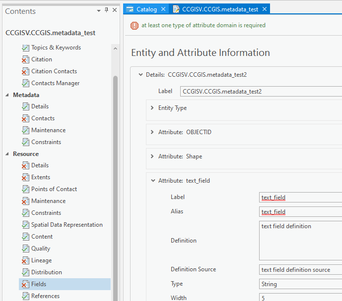

In the ArcGIS Pro attribute editor this is found under Resource > Fields > Entity and Attribute Details
When I add multiple enumerated domain values to an attribute a validation error pops up “at least one type of attribute domain is required.” And I get a red X on the Fields tab.

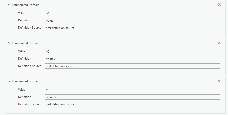

The xml schema it creates for this attribute looks like this:

There is a single attribute domain value (attrdomv) tag with multiple enumerated domain (edom) tags nested inside of it.

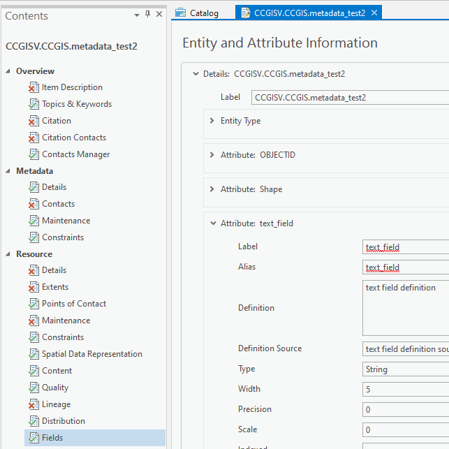

When I manually alter the schema of the xml file to include multiple attribute domain value (attrdomv) tags each containing a single enumerated domain (edom) tag the error goes away. This is true in both the USGS validator and the built in validator in ArcGIS Pro.

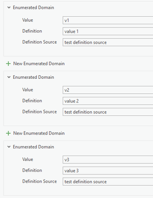

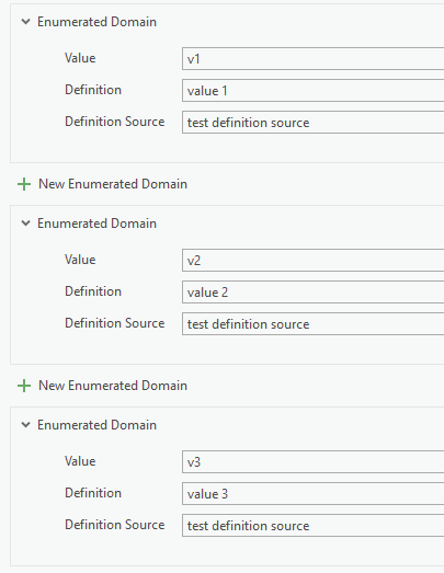

However, the metadata editor now displays strangely for this layer. It is displaying an option to insert a new enumerated domain in between each already established domain.

I have noticed this too with respect to attempting to delete a single edom entry in the Pro Metadata editor interface and having them all disappear! This is a bit of a sticky situation since, as you noticed, the Pro Metadata editor has nested many edom sections inside one attrdomv section. I'm in Pro 3.1.3!
Reviewing the CSDGM schema documentation supports a repeatability of 'attrdomv' with only one 'edom' inside it - so what you are seeing in the MP errors with your default output from ArcPro is correct. It's not pretty, but it is correct.
With the display you see in Pro after structuring a new attrdomv section for each individual edom, clicking 'New Enumerated Domain' will have the effect of creating a second edom inside the parent of the prior/above edom section. Oy... the single attrdomv for each edom structure could get messed up pretty quickly if a user were to come in and add additional domain values using the gui.
I've mapped out the schema and Pro GUI display of the three scenarios that I see... #1 shows one edom per attrdomv, and allows for the next two attrdomv elements to contain their own edom. #2 shows how the Pro editor structures  multiple edoms' within one attrdomv, and #3 shows another variation that seems to be allowed in FGDC-CSDGM where just the edomv/edomvd/edomvds are repeatable inside ONE attrdomv...

I finalized my script (as good as it is going to get for now) and decided to go with the FGDC-CSDGM format with multiple attrdomv tags.
This does not look correct in the ArcGIS Pro metadata editor window, but in my opinion this is  a bug that ESRI needs to fix.
