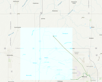

My ArcGIS Pro is acting weird lately, see the screenshot below. If I add a shapefile or geodatabase to the map (in the screenshot, the pink line is a shapefile added to the map), some transparent areas with color will pop up and block the basemap (in the screenshot, the beige, green, and grey areas are blocking the basemap). If I do not display the layer, the basemap will be fine and the transparent areas will be gone. Any ideas what happened and how to resolve this?
Thanks in advance for any insights!

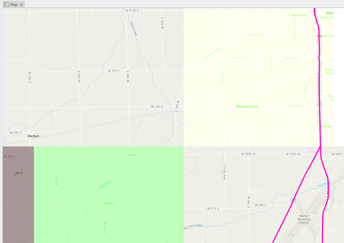

Thank you, Robert! I have tried the first option, but still got the same weird situation. I guess the issue was not with a specific layer, shapefile, or geodatabase, since every file I added to the Map would result in a similar wonky view, even after I re-calculated the spatial index. See the screenshot below.
I will probably need to try the soft reset when I get the chance.

Thank you, Richard! I tried the zoom to function and got reasonable results. I think the issue was not caused by one specific shapefile, since every shapefile - even the one that used to work fine - would cause this wonky view now.
