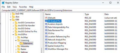

One thing we do is take advantage of where I work is HKEY_LOCAL_USER, this contains copies of most of the HKLM keys that can be set per user. HKLU takes precedents over HKLM. For example, under   HKEY_LOCAL_MACHINE\SOFTWARE\ESRI\ArcGISPro\Licensing\Extensions users can enable or disable extensions. In the .\Extensions keys the names are the feature names.
The extensions information described here is for concurrent use and single use licenses. Named User licensing should be picking up the Extensions settings from the individuals ArcGIS Online subscription.
