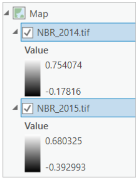

I'm trying to learn how to produce BARC maps and I've been following this guide:
Assess burn scars with satellite imagery | Learn ArcGIS
Once I get to the point where you use the two NBR's to create a difference raster it just refuses to do anything. Does anyone know what I'm doing wrong? Everything has worked perfectly up to this point.

Figured out what the issue was. Arc didn't recognize that I had the spatial analyst license so I just unchecked and checked it and the differencing tool worked

Could you ensure both the layers are selected/highlighted in Content pane, while you run Difference Process.
Think Location
PunkRocksandMinerals
Yes, they're both selected and highlighted but still nothing.
