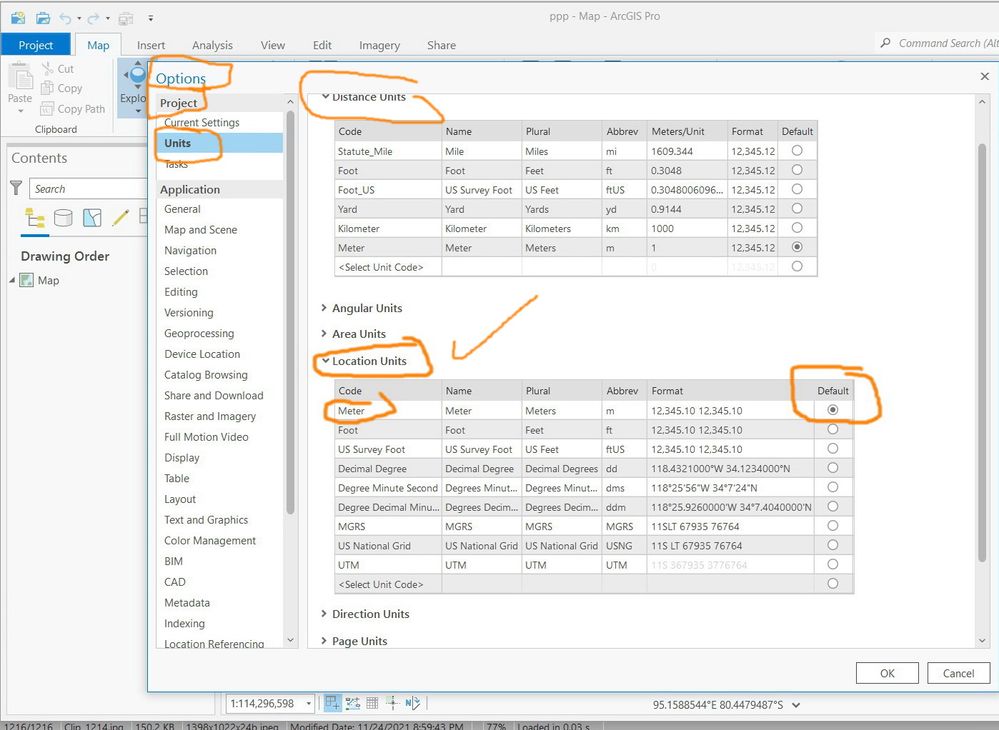

I couldn’t figure out how to set the default unit for map to be in meter

This is to confirm that I got the same behavior as you when I close the ArcgisPro after setting the units to meters, the setting from the option dialogue box reverts back to foot when I open it again and start a new project.
but I noticed that it is mentioned clearly that the units setting is for this project only, and not for the application, so when you create a new map in the same project you will get the same units, and if you open it again, the pro will keep the same setting for this project. I do agree with you jamal, esri should add the units settings under the application and not for each project (the same as the map).

This issue persists to exist in 2.9.
Despite the fact that the “location unit” is set to be “meters”, as the project starts the default is kept at “decimal degree”.
Also, we need this setting to be at the level of application but not at level of aprx

Actually, on second thoughts, I belive that my facetious comment was actually true.  That "Default" button does actually do something different to what I thought, and I believe that it does actually work as intended.
Note that the "Units" options are under the "Current Project" category of Options!  If I change the default Location Units while in an open project, then it DOES actually work for any new map opened WITHIN THAT CURRENT PROJECT.
If I open a new project, then that will have reverted to ESRI's default.
What we really need, is a default setting that is universal, and not per-project (ie, what most people expect "Default" to mean!).
