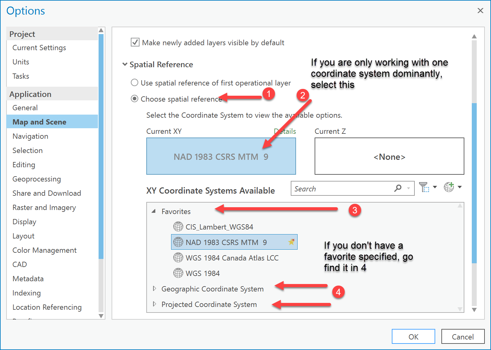

You select the radio button under your checkmark.  If you have added one to Favorites, you should be able to select it otherwise you will have to scroll through the Geographic and Projected coordinate systems to find the one you want

Like this...

Thanks Dan. It works fine with me.
