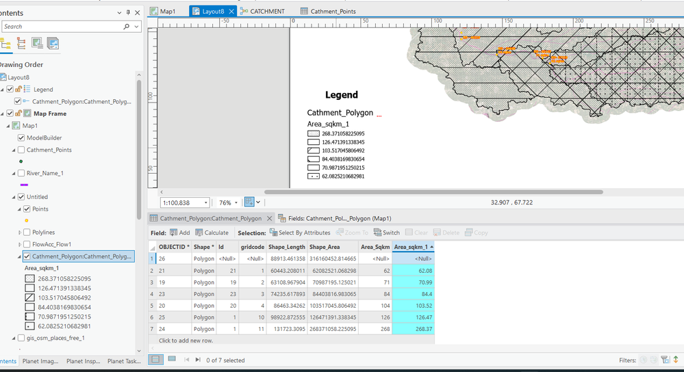

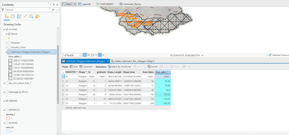

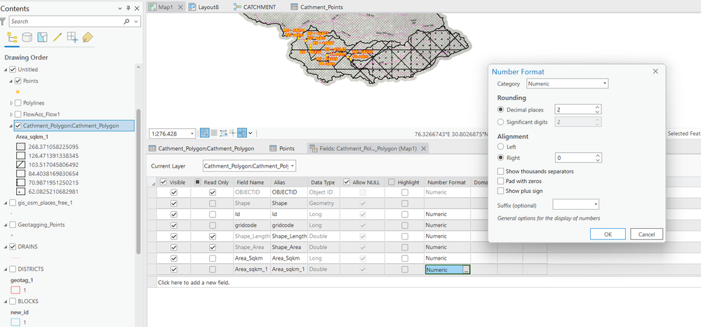

I have done "Rounding" to two places in "Number Format" in "Fields" of a table, but when I insert that label in Legends the decimal places are displayed as in shown without Number formatting.
Arc_Labels_Problem.pngArc_Labels_Problem.pngArc_Labels_Problem_2.pngArc_Labels_Problem_2.pngArc_Labels_Problem_3.pngArc_Labels_Problem_3.png

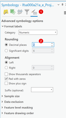

symbology tab. advanced labelling
