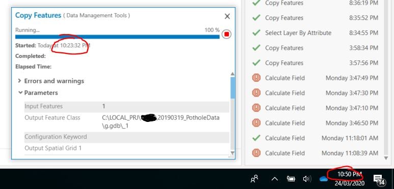

I am using the copy features geoprocessing tool. Copying a hosted feature layer to a local fgdb, with attachments so it should churn for a while but....
The progress bar jumps to 100% quite fast but then just sits there. See screenshot. It's been at 100% for 20 mins.
What is happening here?

Peter MacKenzie‌ did you set the environment in the Python window via arcpy.env.maintainAttachments = False, and then run the tool through the Geoprocessing pane UI? Once the project environments are established, changing the arcpy.env does not impact the environment settings for your project or the tools run in the Geoprocessing pane UI. You can think about it as a one way street - the environments set in the project are automatically derived into arcpy.env, but changes in arcpy.env don't flow up to the project environments.
This could be a reason why the tool is stuck at 100% for a long time - the maintain attachments setting never got disabled for tools run in the Geoprocessing pane UI. Transferring attachments is a post process of creating new relationship classes and transferring potentially large amounts of binary information in blob fields into a new table in the geodatabase. The progress bar accounts for the feature transfer, but not for the attachment transfer which is a much less deterministic process, as each attachment can be a different size and require more or less processing time.
Dan Patterson‌ had a hunch about that output named g.gdb\_1 -- the geodatabase does allow this name, and I could successfully run CopyFeatures with an output named _1.
Russell Brennan‌'s suggestion about Fiddler would help to debug if queries are still being made to the service or if things are stuck on the client side for a long period of time. Working with Esri Tech Support would help to do some of this troubleshooting for you.

Sorry, my mistake. That was actually arcpy.env.maintainAttachments = True as I was needing to maintain attachments. I think you might be right Drew Flater‌, it had a significant amount of attachments so the progress wasn't really a good indicator of thus, I have fiddler but need to work out how to use it next.
