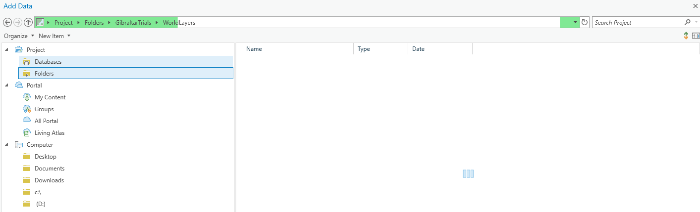

AcrGIX Pro makes life for users really unpleasantly frustrating.  My current gripe is the non-standard file selection dialog you have designed. To be perfectly honest it is a dog. Even opening a folder on my local SSD takes as long as 20 seconds, while the standard microsoft file open dialog is instantaneous.  All I see with ESRI are you multiple, lame, busy icons.(they are a crutch, not a solution, if it was quick you would not need these). If we are being honest, the user is not busy, the computer is not busy, your poor architecture is incapable of providing an effective user interface.
We have no idea what this dialog is trying to do, but whatever it is, it has no end-user value in the delays it causes.
Can I please ask you offer the user an option (in options) to use the standard MS dialog instead? Pre-scanning folders is not a sensible strategy if it slows users down.

Dan, indeed you are correct.  I set a filter on wireshark to what I suspected was a 'ET phone home' from my maching to 18.234.22.44.  as soon as I open the 'add data' it floods my network with calls to planet ESRI, even if I am trying to open a local file.Of course when you are not in the ESRI campus there will be latency.  Here in Australia the USA is a long way away, and apparently not of any interest/value.

I suspect the issue is to do with network latency.  the architects appear to have assumed everyone is online and has zero latency. Western Australia is about 320 milliseconds from Calfornia, so ten TCP request/replies will take 3 seconds to complete.  I can see hundreds of requests, so a couple of minutes for the file dialog to open is about right.  That does not make it an acceptable design, or sustainable for users.
