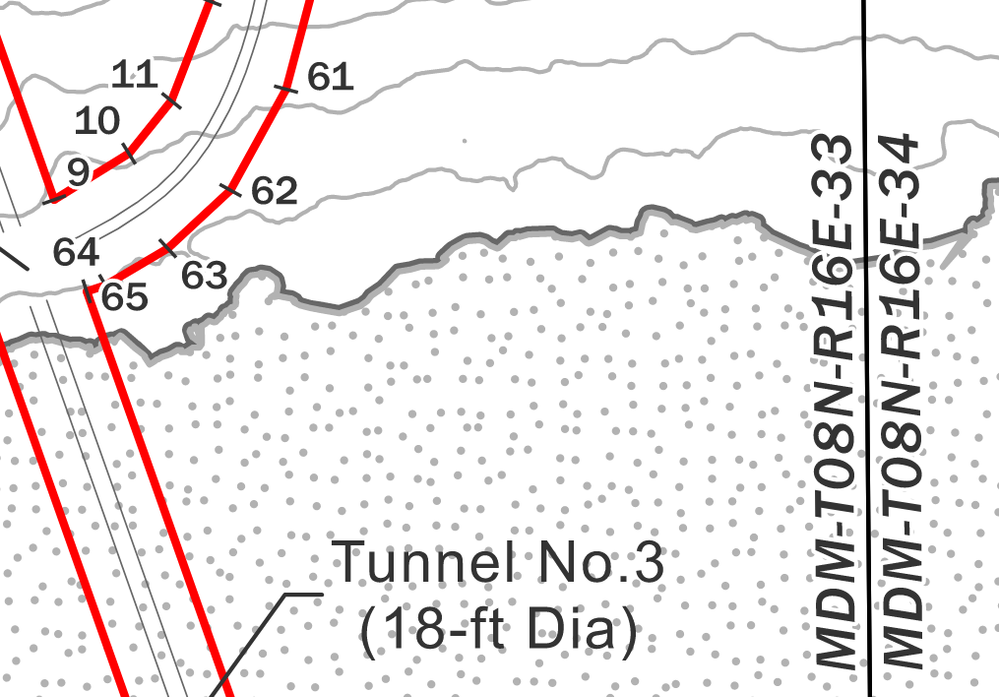

HOW IT LOOKS IN PDF VIEWER

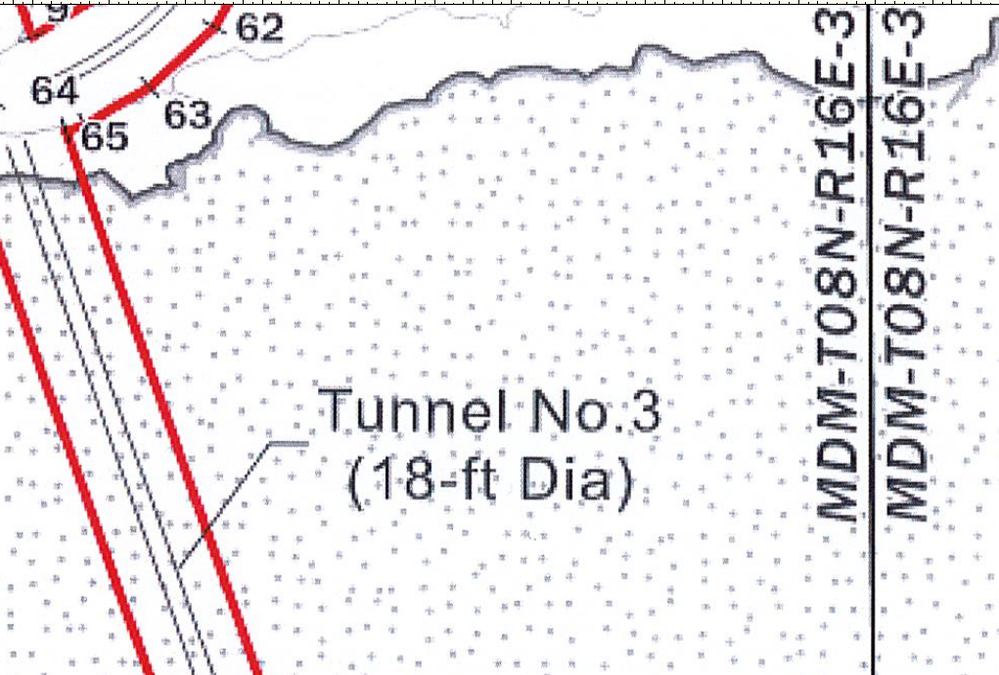

HOW IT PRINTS (printed then scanned; I understand scanning involves loss of quality, but this fairly close to print)
As you can see, the red lines are clearly aliased.  I've tried all combinations of checkboxes in ExportToPDF from the GUI, including 1) Embed Fonts 2) Compress Vector Graphics 3) Turning off Halos 4) [there is no Transparency]. 5) Printing at original PDF size too.
