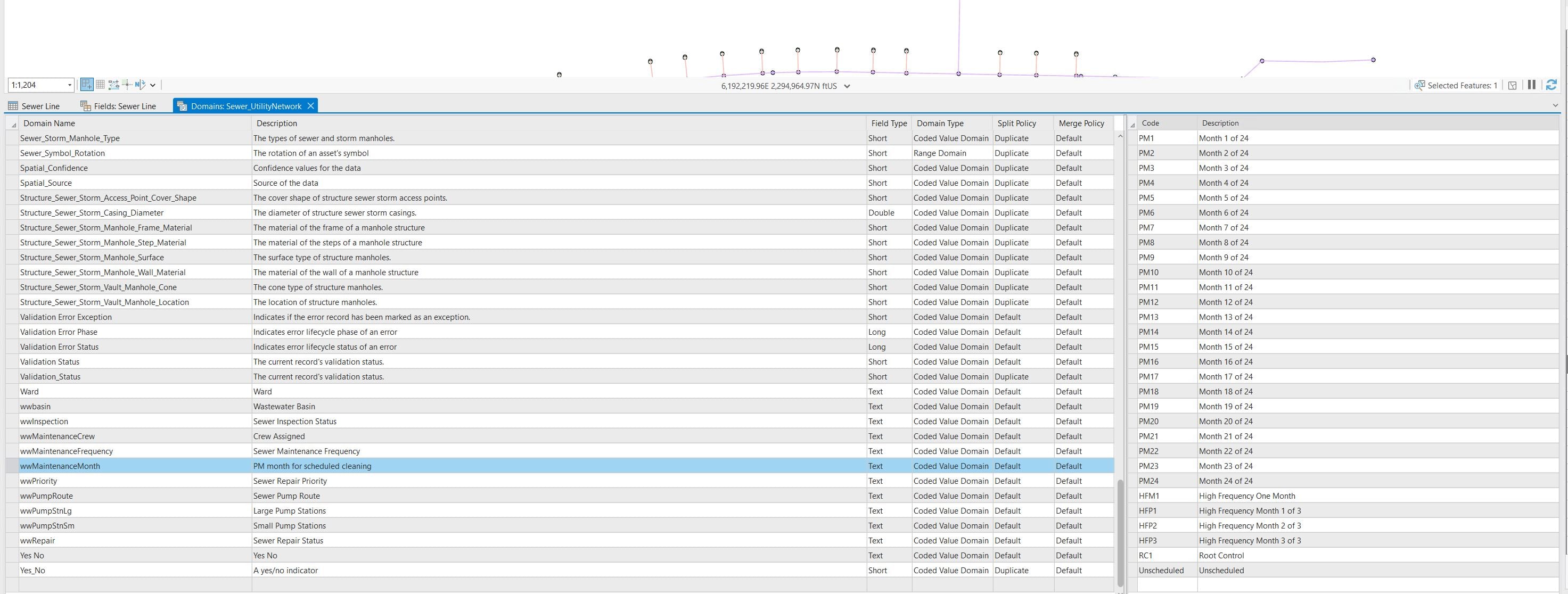

The first model I built took the database and created a bunch of domains and added values to them so that I could call them in future steps. worked perfectly.

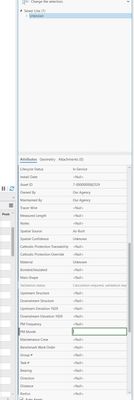

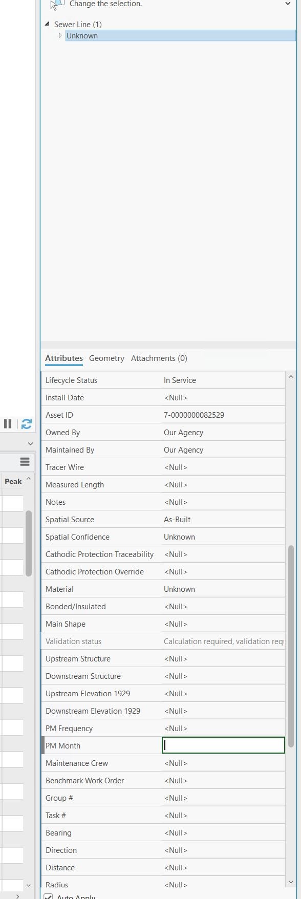

The second model took the feature layers as inputs and added fields to them, applying those domains. Again, worked perfectly. When looking at the data and at the database I can see the domains, values and everything as it should be, the same as the fields I didn't create.  But the drop down to give me a selection is not appearing for these new fields. I have checked every thread and tried every solution I could find on the topic, but no luck. I tried editing in the attributes tab, the values are not showing up there either. I look in the settings and they are all listed correctly. They are even listed if I look at the fields to select a default.

 Here is an example of one of the created domains, and its values in the db domains section.

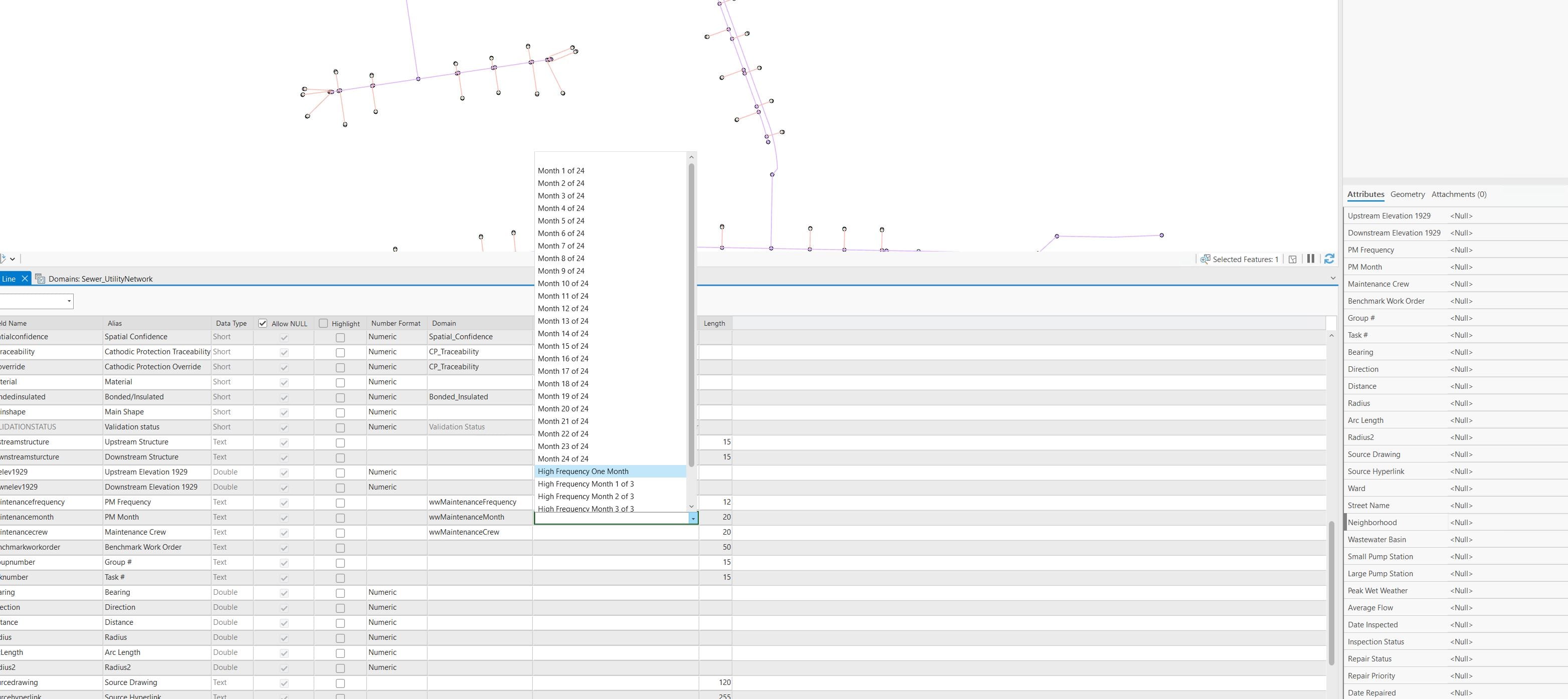

 setting the default is easy, all the values are showing up. but if I try to edit one of these fields in the table or attribute toolbar, nothing is there.
