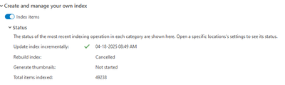

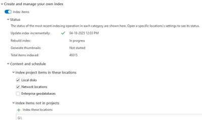

Hello,
ArcGIS Pro will only index a portion of my GIS data before canceling out after about 50,000 records. Is there any reason why the index will not complete?
*note, the Arc Catalog index is quicker and does not have any issues.

Hi LyonMNGIS,
I don't think there's an obvious reason why the indexer would fail on you--there's no record limitation, for instance. It might be encountering bad data somewhere in the file, but that seems questionable since you're able to index the same data (right?) without problems in ArcCatalog.
You should probably open a case with technical support so they can repro and diagnose the problem. If you don't have support authorization, I think you can still open a case with them because it's a software bug--at least it seems to be.

@LyonMNGIS as stated on the thread, there isn't a know reason why indexing would stop as there is no built-in limit. If you're able to share the data that causes the problem, the best way to do that will be through submitting a case with Technical Support. Thank you
