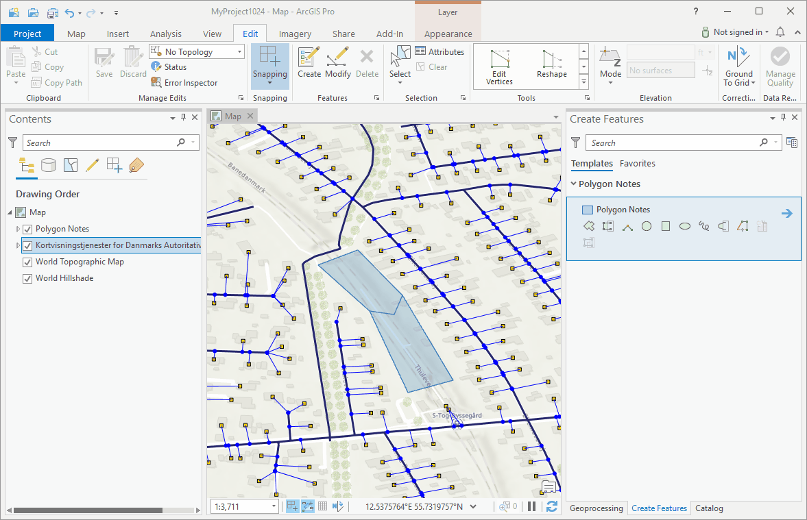

Scott_Harris
Hi Morten,
I tested the workflow you provided and could reproduce a crash in 2.4.2 but not in 2.5, which is not released yet, but coming soon. Thanks for reporting it to us. For what it's worth, here is the workflow with no crash in 2.5:
