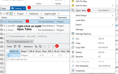

So when you are in Catalog View, and you are displaying all the layers next to the  Contents.  Problem is when you try to use the keyboard up and down arrows  to view each layer's table.
I looked at the shortcuts and tried to use it but no luck.
Is there a way around to do that ?
DanPatterson
MVP Esteemed Contributor
For both View and Pane,
navigate, right-click on what you want, then open table
