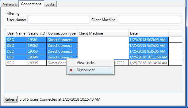

In Arc Catalog (10.5.1), when right-clicking on a SDE geodatabase connection, selecting properties, connection tab, show connected users, one can select ALL of the connections and right-click -> Disconnect.

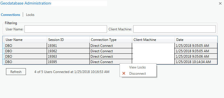

In Pro 2.1, same steps, however once you right-click (after selecting all of the connections), the selection is lost and you are only able to disconnect whatever connection the mouse pointer happened to be over.
Forcing disconnects is an essential part of enterprise geodatabase administration. Many of my geodatabases can have dozens of connections. Having to right click on them one by one.....

We had [BUG-000112112: Cannot select multiple locks in the database connection properties in the Show connected users and locks... dialog in ArcGIS Pro] logged and that is marked as fixed in Pro 2.2.
Are you on 2.2 and not seeing the ability to do this?  I think Thomas Colson‌ may also have been reporting that he still didn't see this option in 2.2 but we weren't able to follow up at the time.  Michael Volz‌ let me know what version of Pro you're on, and if 2.2, we may need to get some more details to see what's going on.  Thanks

Kory Kramer‌ since we last talked about this, what I've learned is you have to remove the SDE connection from your project and re-add it for the the functionality to "kick-in".

Thanks, Tom.  Michael Volz‌ if you re-add your connections to a Pro 2.2 project, do you then have the ability to multi-select and disconnect?

This functionality is working as expected in Pro 2.2 where it looks like this bug has been fixed.  Luckily for me my org does not have production aprx files yet, so we would not need to worry about removing and then re-adding SDE connections to get this fixed functionality to work had the aprx been created in a previous version of Pro.
