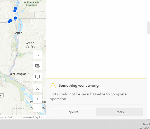

We recently created Attribute Rules in our enterpise SDE and published to our Enterprise Portal as a 'referenced service'. When editing in map viewer we see this error:

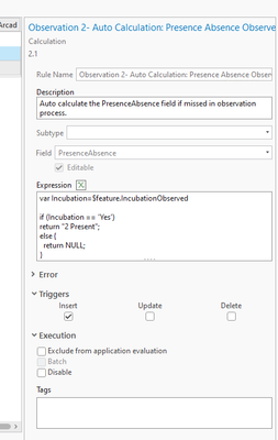

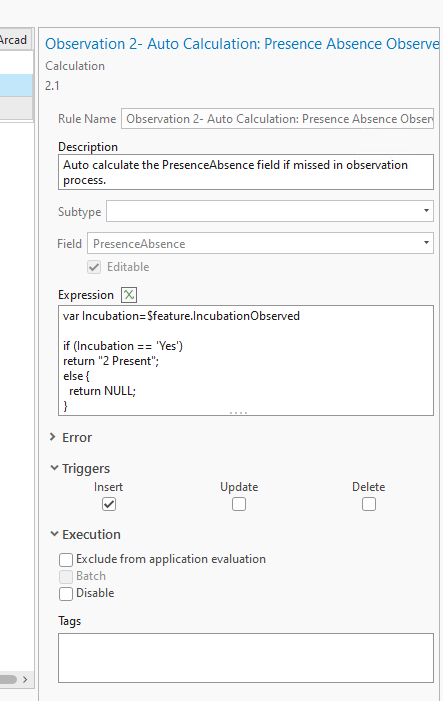

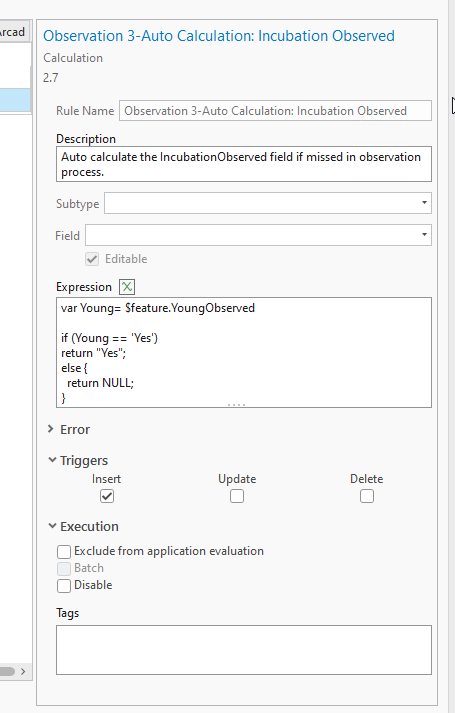

    • We are using “Immediate Calculation Rules” and here are the arcade expressions/configurations:
    • Something else to note- these attribute rules are created on a related table. Users will be adding new related records as part of the workflow, both parent table and related table are in the same ‘referenced’ service with “add” and “Update” editing enabled.

I was also getting the "Something went wrong Edits could not be saved: Unable to complete operation." error.
Install Telerik's FIDDLER and watch your browser's web traffic, you should see a failed request come through when you hit Create or Update.  Click on that and you'll see a way more useful error message.  It would be nice if they put the failed rule name in that generic error message.
