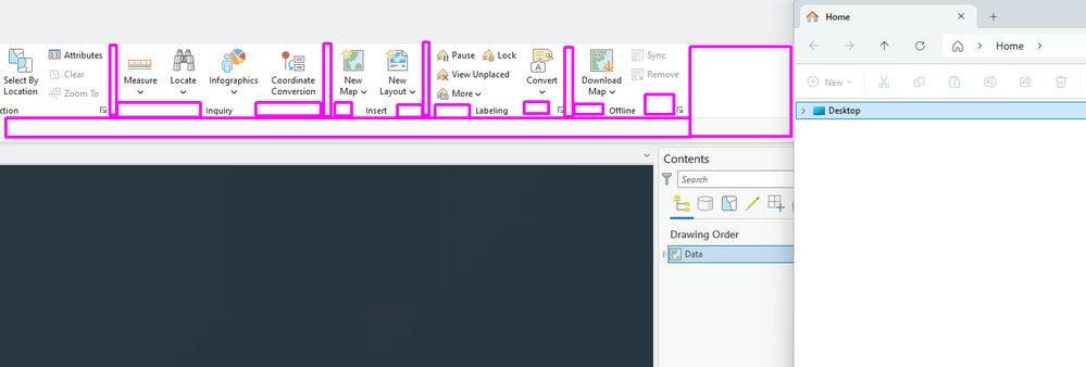

If Pro 3.5 is partially behind another application window and you click in a blank part of the Ribbon or QAT, Pro will not come to the foreground. You have to click inside another part of the application window.
Clicking in the pink areas does nothing when Pro is behind another app (File Explorer in this case):

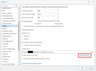

  3. Does clearing the display cache resolve it? This button in Options > Display:Scott_Harris_0-1747228288012.pngScott_Harris_0-1747228288012.png
