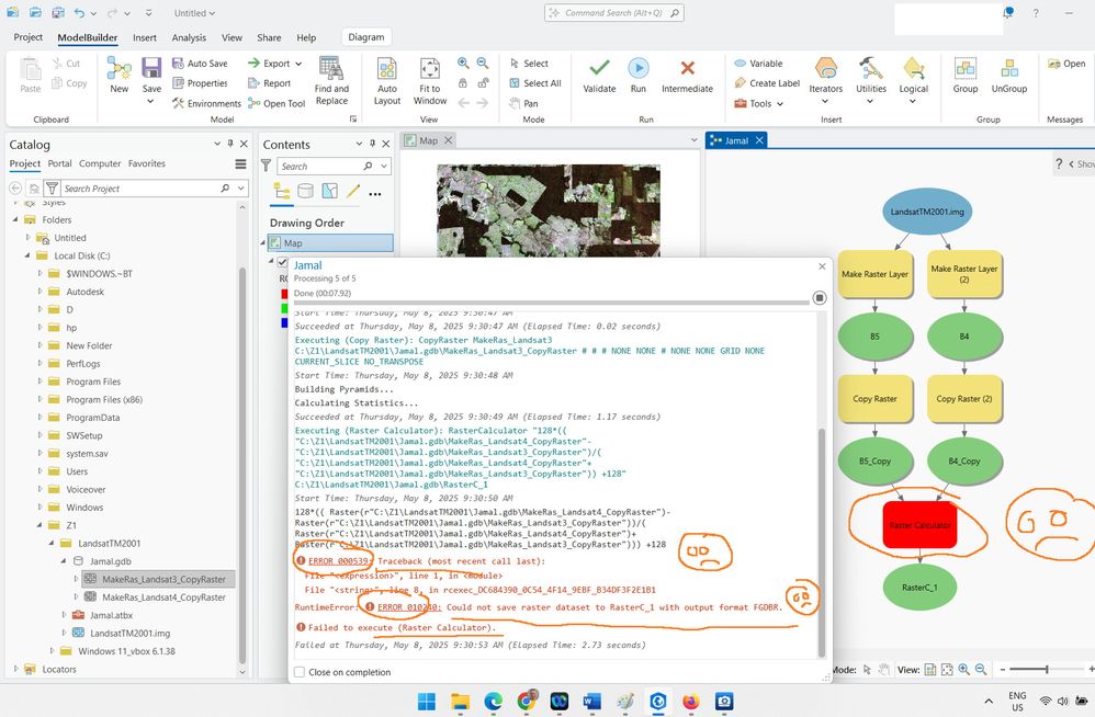

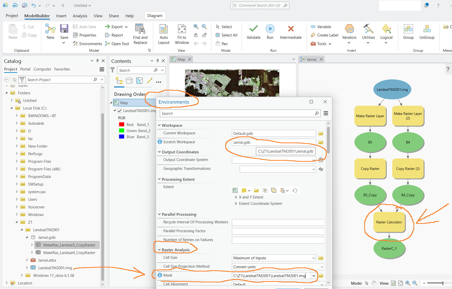

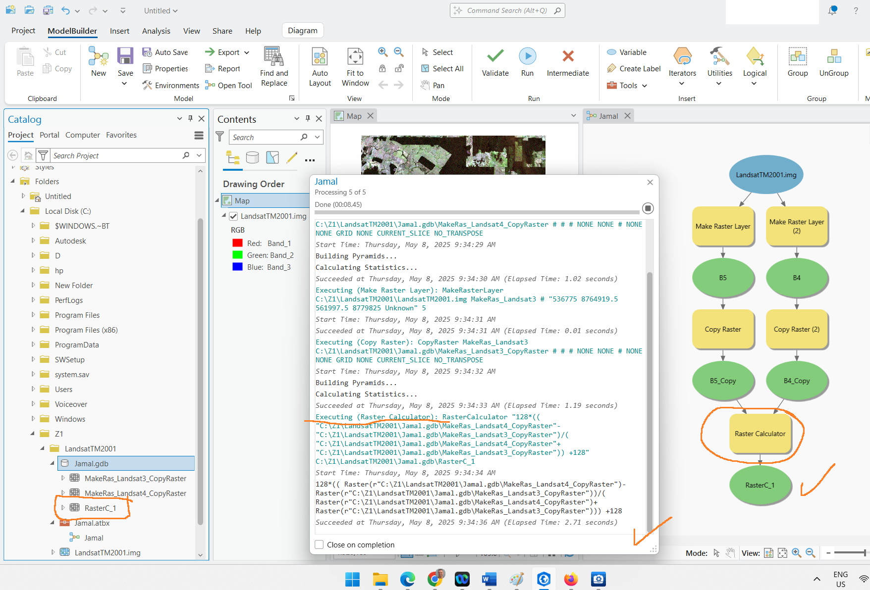

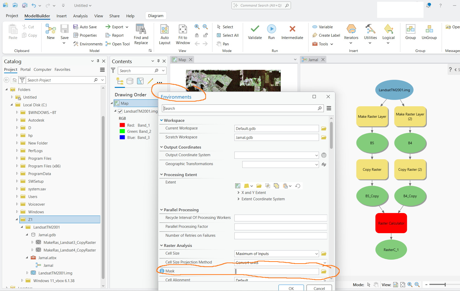

In the screenshots below, if the mask is set to the “LandsatTM2001.img” raster, then performing the “raster calculator” tool results in “ERROR 000539”. If the mask is left blank, the “raster calculator” tool works successfully.
What could be the issue here?
The data is attached

The issue shouldn’t be related to how the equation is written in the Raster Calculator, as the same equation works fine when the mask is left blank.

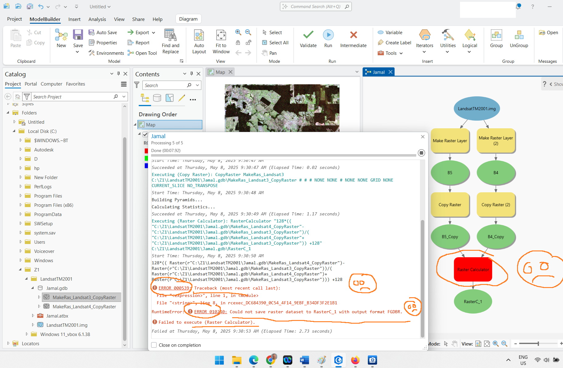

No clue then since the form you have written now in the raster calculator looks totally different than the parsing error that was being thrown in an earlier image.
If the raster extents, cell size and alignments are all the same, your current form should work.

From the very beginning, the issue has not been with how the equation is written. The problem can be reproduced by using the same equation—once with a mask applied and once without.
