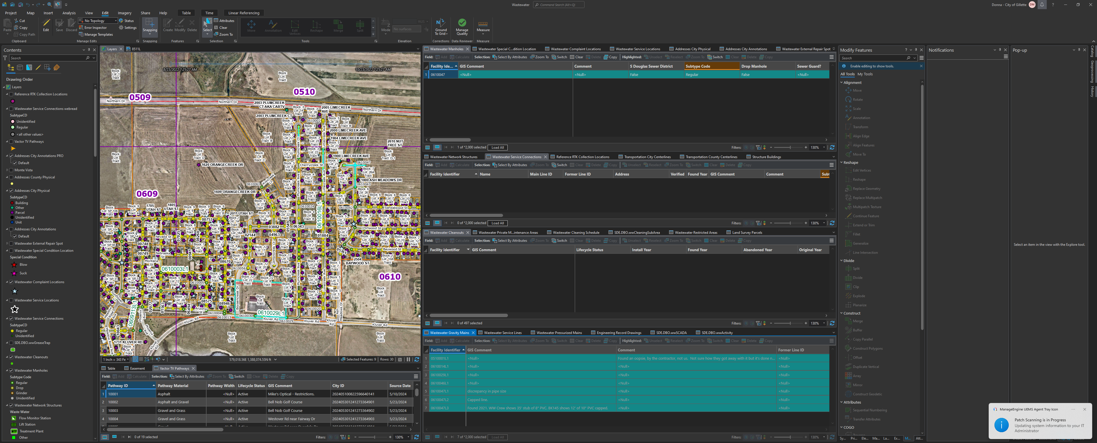

Hello,
This issue appeared in version 3.3.1 also, but it seems to happen more frequently in version 3.3.2.
Scenario:
I selected multiple rows of data in a feature class called Wastewater Gravity Mains. I zoomed in and out of the map a couple of times, then switched the Attribute Table (not window) view to Selected records. It's like the table froze, and icons at the bottom of the table grayed out so that they could not be selected. Sometimes, the records in the table even empty out completely, even though they are still selected in the map.
My solution has been to close out of the Pro session, and when I open it again, everything is fine. However, sometimes that does not work, and then I have to remove the table completely and readd it.
Is there something I am doing incorrectly or could this be a bug in the system?
Thank you,
Donna
