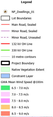

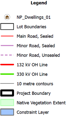

3.1.2 - i am having the same issue, legend for a raster layer is showing before i export print to pdf, then after export only the legend for raster layer is not showing. All other vector legend items show up. Does not seem to be exactly the same as the reported Bug.
OliverScheidegger
Legend before exporting as pdf
OliverScheidegger
Legend after exporting to pdf, ArcGIS Pro why have you dropped of the raster legend item??????
OliverScheidegger
Confirmed the issue only occurs when "Only show features visible in the map extent" box is ticked.
When unticked, all legends items including raster layer is visible in exported pdf.
