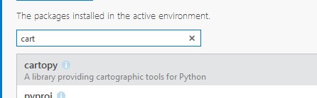

Doing this successfully installs the package and it also shows up in my Package Manager afterwards:
