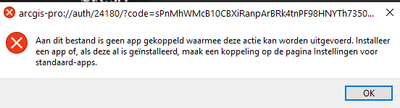

I just tried Firefox (version 88) and I got this error:
It says that there is no application available to open the link.
