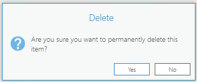

Here is a difference that I'm seeing though when I try to delete a feature class (from the Catalog window) that is the source of a map layer in ArcMap:
In Pro, I am not given the same head's up about this action potentially affecting map content...

Ok, so just to give you a use case. I have a layer that is pointing to a feature class in one geodatabase. I want to point to a feature class that has the same field definitions in a new geodatabase. The only way I can do this safely is to right click on the layer, select Properties > Source > Set Data Source before deleting the initial feature class. I assumed if I deleted the feature class from the geodatabase, that ArcGIS Pro would just provide a red exclamation mark beside the layer as it does if I open my project and the data sources are missing. If syncing the layer with the data source by deleting it is the expected behavior, then an updated warning message would be worthwhile.
