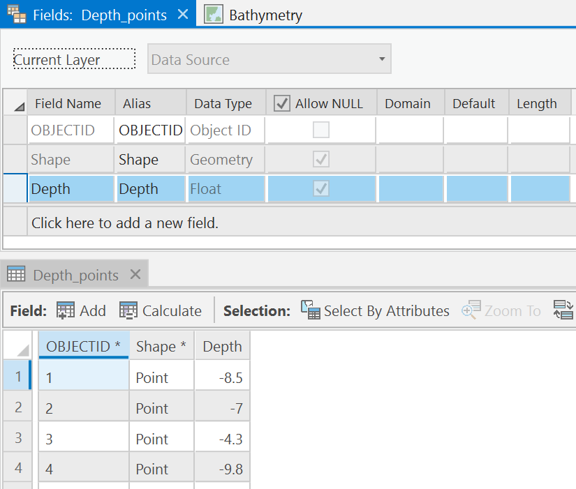

When I try typing in values to a float field* in a point File Geodatabase Feature Class's attribute table, ArcGIS Pro completely freezes, requiring a forced quit from Task Manager. Weirdly, I do not experience this issue on my own laptop running the exact same version of ArcGIS Pro, even with the same project ported across on a USB stick.
I've tried fully uninstalling and reinstalling ArcGIS Pro and ensuring Windows is up to date, but the issue remains. Has anyone else experienced this, and found a way to resolve it if so?

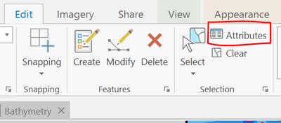

I've discovered a workaround since posting this just in case it helps anyone else - editing the field via the attributes pane (as opposed to the attribute table itself) while the row you wish to update is selected seems to avoid the freezing problem.

Are you sure the problem is limited to float fields? I ask because you only have 1 field in that feature class in the screenshot. Also, where is the File Geodatabase located? On the local machine in your office, on a network location? To help narrow down these types of things, you can contact Esri Technical Support: https://support.esri.com/en/contact-tech-support
ChrisNewton
Thanks for the reply Scott. Apologies - I have checked and can confirm the same problem occurs with all data types except text. I'll update my original post accordingly. The File Geodatabase is on my local machine in this case.

The work around that ChrisNewton mentions works well.
