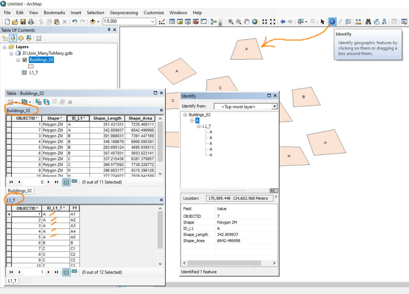

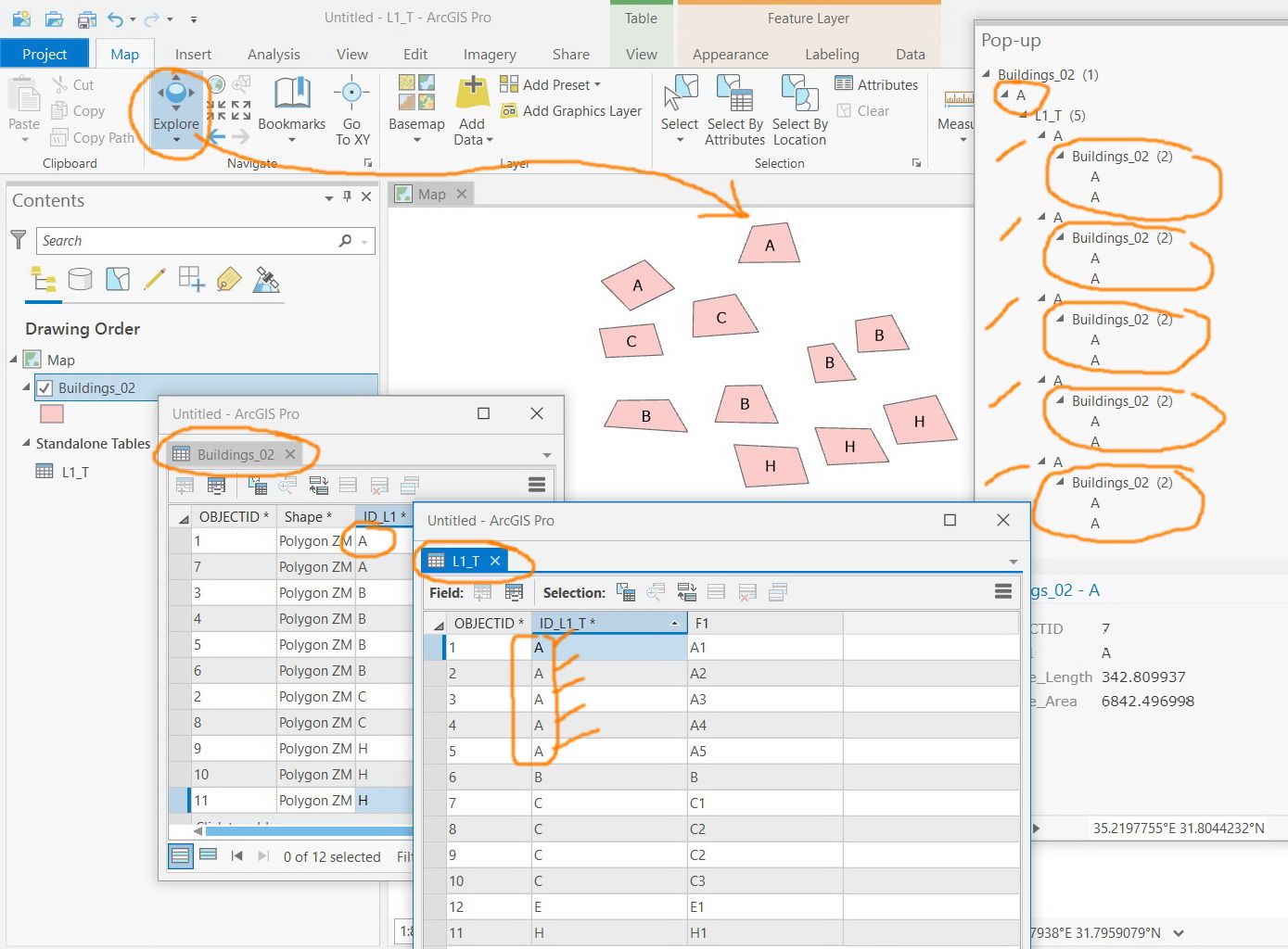

I observer that the result of identifying in Pro is a bit different from that in ArcMap.
In the screenshot below, identifying the marked features in ArcMap brings 5 related records. Performing that same commend in Pro brings 5 related records too in addition to relating each record with its corresponding values from the feature class.
How to get the Pro behaves as ArcMap when performing "identify"?

Hi Jamal,
If you remove the related table from your content, you will have the same behavior as in ArcMap.

Thank you Rawan for the help.
but what if I need to keep the stand-alone relate table in the content?
