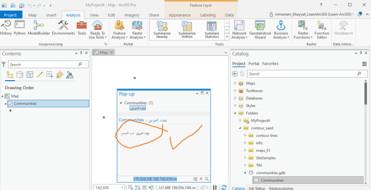

This should be easy but I couldn’t figure out where to find the “display” tab in Pro from which a particular field can be set as “display”

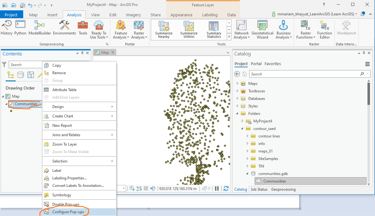

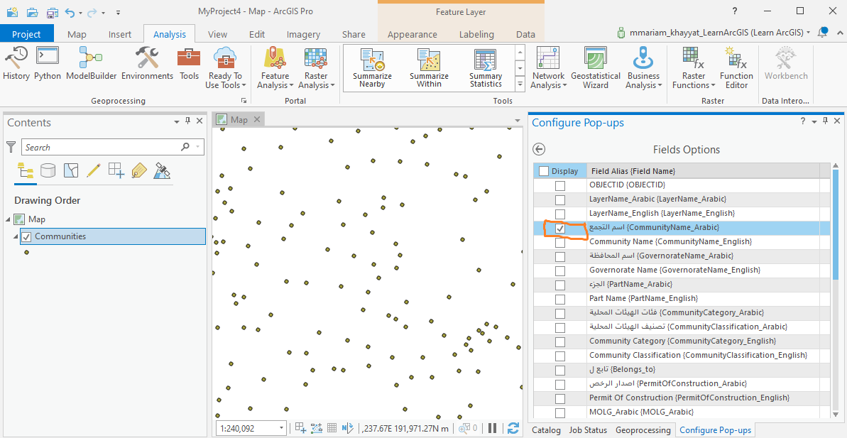

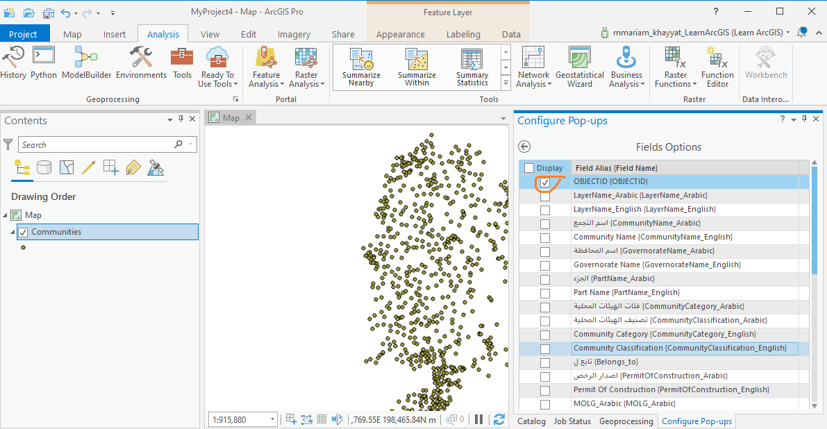

Hi Jamal
Please,note the following steps to display a specific field as "dispaly" in ArcPro 2.5
Hope this could answer your question

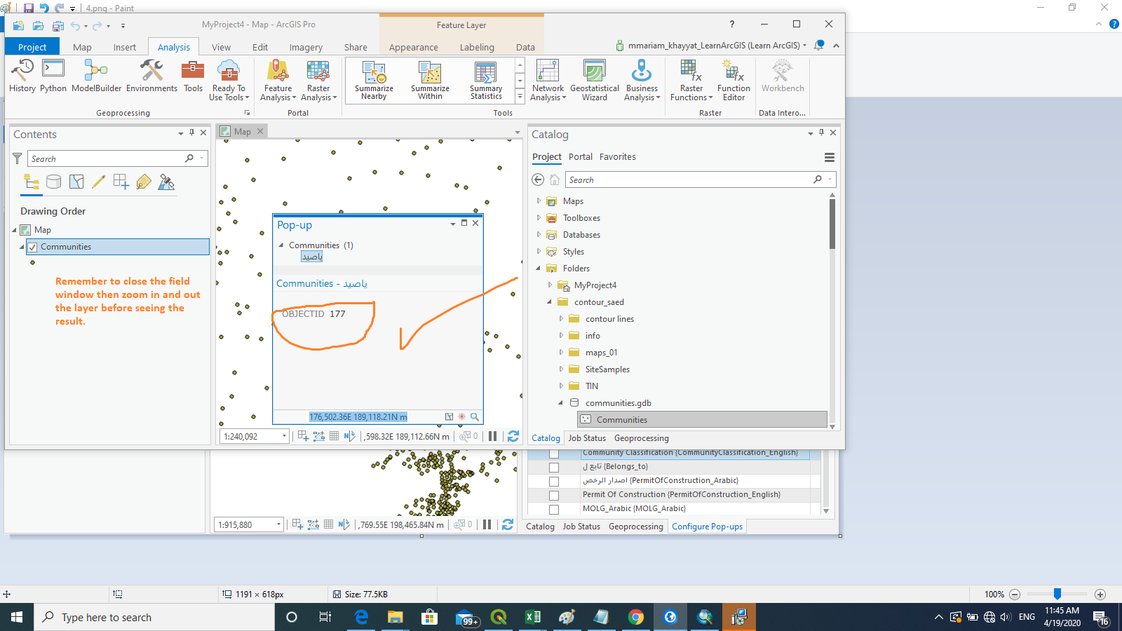

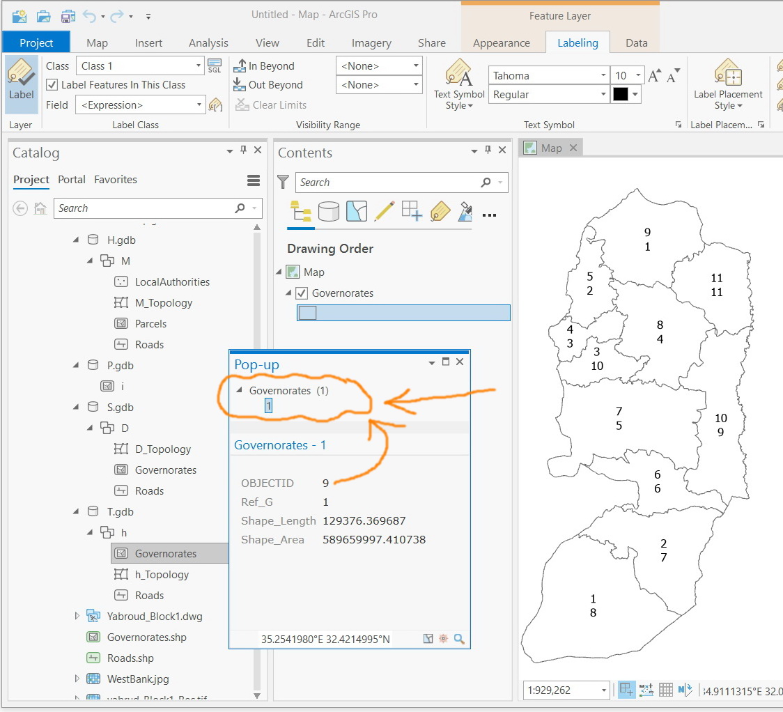

JamalNUMAN
Legendary Contributor
Many thanks Mariam.

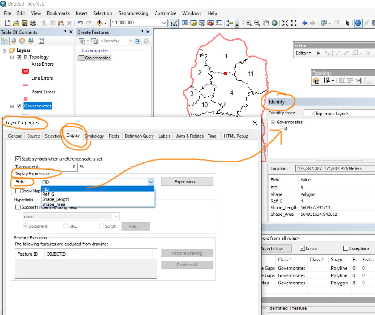

What I wanted here is to specify the field which its value will appear on top of the pop-up value as it is shown in the screenshot below
Jamal Numan
KarstenRank

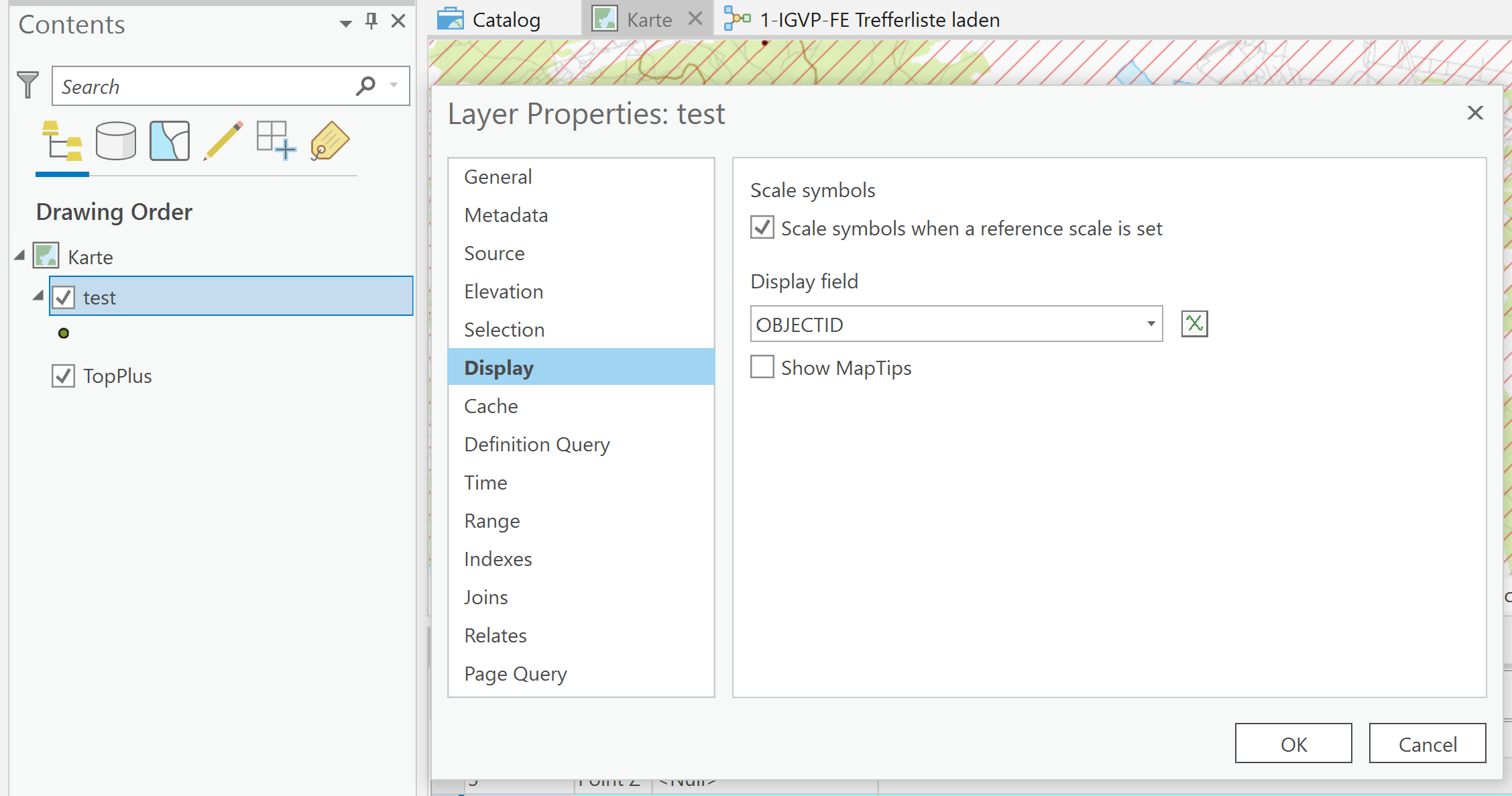

Hi,
it is the same way like in ArcGIS Dektop.
Open the properties of the layer and choose the field to display.
