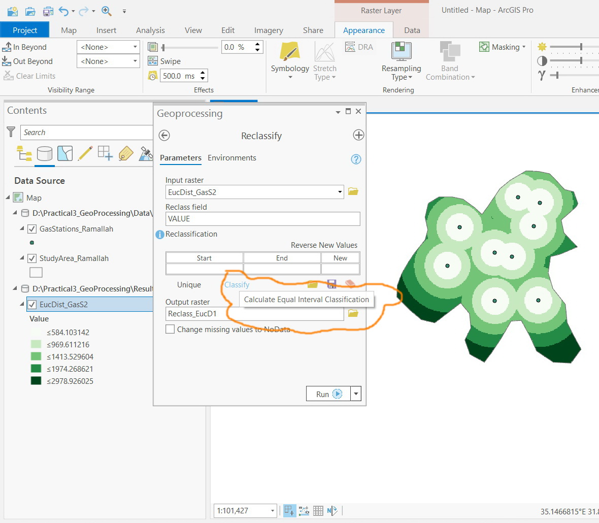

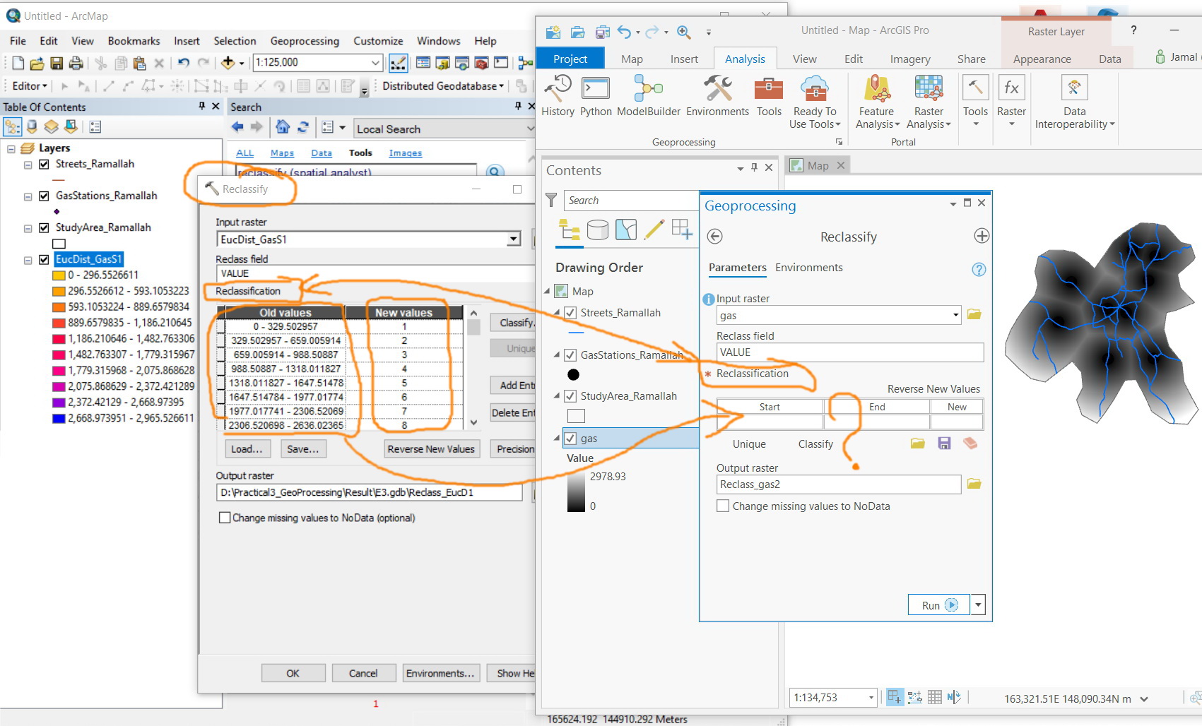

I couldn’t figure out why “Reclassify” tool in Pro doesn’t bring automatically old and new reclassification values as it is used to perform in ArcMap
Is there any workaround for that? Do we need to type them manually?

Fortunately, it is there!

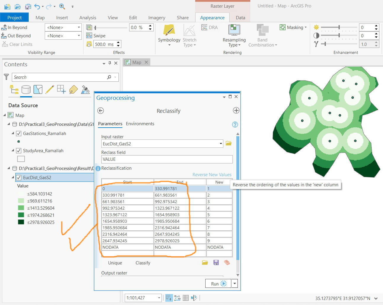

It wont take all the stretched values. If you set up the classified renderer on your symbology on your layer then drag and drop, it should bring in those ranges in the tool (close and reopen the tool window beforehand).

I would prefer the behavior of ArcMap as these ranges are displayed by default where in Pro one needs to perform more clicks

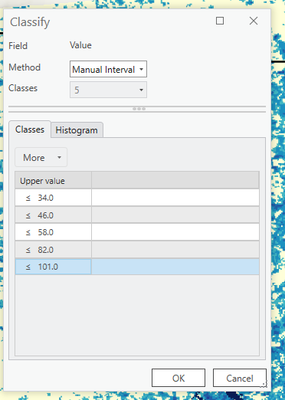

I am struggling with this interface also.
If you pick manual it greys out the number of classes?
I cannot get ranges to work at all.  No matter what syntax I try it does not work.  I still get a output with the old values.
I just want 0-49 = 0 and 50-100 = 1.  The help only shows code samples and 0 samples using the interface that I can find.
