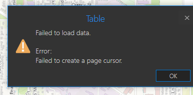

I just opened a pro project that was created pre 2.5 upgrade. I can see my data as expected.
When I try to re add that table to that project or any other made after the upgrade we get an error.
FAQ: What characters should not be used in ArcGIS for field names and table names?
After looking into it, I believe that the error is because pro is adding quotes to field names. Only on the layers that have a _ before hand.  This did not happen in a pre Pro 2.5 project and does not happen in desktop products. I downgraded to 2.4 and the table added without the quotes.
We do not have access to the database and cannot change the field names.
Any suggestions on a work around?

What is the source of the table and how are you connecting to it?
That should just about do it....
RickeyFight
MVP Alum
Joe Borgione
A table from a SQL server.

Do not start field or table names with an underscore or a number.
RickeyFight
MVP Alum
Dan Patterson
I am not sure why it was created that way but I cannot change the field names on the database at this point.

I installed the new driver and it did not work.
Unfortunately we are not running SQLite.

Just because it worked in previous versions, doesn't mean its supported. Try running Validating table and field names in Python—ArcPy Get Started | Documentation
 Also see
Fundamentals of adding and deleting fields—Help | Documentation
Naming Stuff In ArcGIS - USGS OEI/Enterprise GIS - myUSGS Confluence
When I try to create an attribute in 2.5 starting with "_toast", not only does it create "_toast", "f_toast" gets created as well, which is odd. Perhaps this is one of the several new bugs that were introduced with 2.5.
I recommend opening a case with tech support. I think you're out of luck on the quotes thing, but I'm curious as to their response both on existing fields created pre-2.5 that start with "_", as well as what's going on when you create a field in 2.5 starting with "_" and why a second one gets created with "f_".
