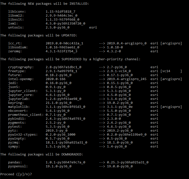

After upgrading to Pro 2.5 I cloned my python env and began installing both the dltsolutions package and the untools package.  The untools version listed was 2.5.0.  The dltsolutions package installed fine.  However, the untools package never finished.  After trying to reinstall, the highest version available was 2.2.  Figuring that this probably wasn't right, I opted to install via the ArcGIS python command prompt.
A 'conda search untools' command did result in seeing v2.5.0 available.
A 'conda install -c esri untools' command gave me this:
Again, my initial install of the untools package resulted in only one version option, 2.5.0.  A second attempt resulted in the ability to choose only 2.2.0.x versions.
What do I do?  Install and keep the superseded packages and then force the downgraded packages?  Roll back to Pro 2.4?  This doesn't pass the sniff test but I am not a python package expert...

conda install blahblah --no-pin --dry-run
to see what will happen, most of the pinned files don't cause issue in my experience
Most of those in your list is because esri is put at the top of the list in the
.condarc  file .... its contents
channels:
- esri
- defaults
hence the nag.
If you want to try ... conda install blahblah --no-pin .... the worse that can happen is that you have to revert the revision.. from the conda prompt
conda list --revisions
conda install --revision xx
where xx is some number

Thanks, Dan.
I proceeded with the install.  Since it's a cloned environment anyway, the loses won't be that big.
