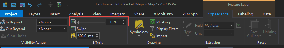

Just to add to this explanations, I've found the most reproducible way to avoid this issue is to set transparency at the color level and not the layer level. I've gotten to where this is my default way of setting transparency for just about any layer.
Leave the slider on the appearance tag at 0%
Go to the color properties in the Symbology panel
And set the transparency for the individual color
