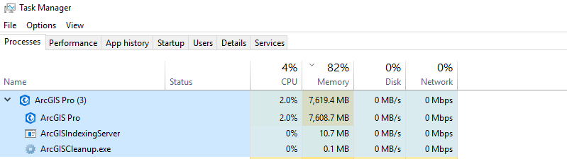

I'm working on elevations in scene and it sometimes hangs when drawing previews. No amount of waiting seems to be enough.Interestingly the memory consumption looks high, while the CPU isn't doing anything. The CPU use goes up and down from 1-2%, the memory use barely changes.  Suggestions?
