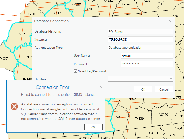

Hey, pro 1.1 is extremely promising, lots of good stuff.
We use "Query Layers" (map layers resulting from a SQL Query which returns a shape column).
My database connection works fine in 10.2, but it will not connect in Pro with the same parameters:

SSMIC3038
Just  upgraded to 1.1 and I'm getting the same error message, can't figure it out.
Any help is appreciated.
QuinnFrancis
Which version of SQL Server are you using?  At ArcGIS Pro 1.1 the minimum supported version is SQL Server 2012 SP1.  What version of the native client do you have installed?
Microsoft SQL Server database requirements for ArcGIS Pro 1.1—ArcGIS Pro | ArcGIS for Desktop
QuinnFrancis
Try installing the SQL Server 2012 Native client from MyEsri or from the Microsoft website and test your connection again.
Download Microsoft® SQL Server® 2012 Feature Pack from Official Microsoft Download Center
SSMIC3038
That's likely the problem, were on 2008, upgrade to 2012 is in process.
Thanks.
HeatherScroggins
Once I upgraded to SQL Server 2012 SP1 I had no problems with connecting. If you haven't already, I would try that.
