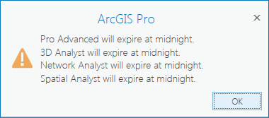

Greetings,

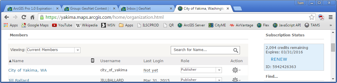

I am getting an expiration message each time I start ArcGIS Pro and it is about to expire.  I have looked at my ArcGIS Online licenses and they are good until March 31, 2016.  How do I make sure that my license for ArcGIS Pro is renewed?

I tried signing out of everything and did a good ole reboot.  It still says it is going to expire and midnight.
Maybe it will just rollover automagically   I guess I will find out tomorrow and then contact tech support if need be.

I was assuming that it is all controlled by AGOL too and my expiration does show a year out as follows:
I will let you know!
