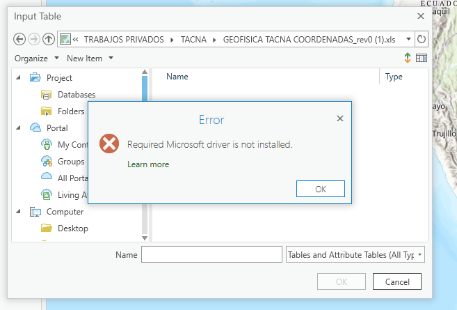

i need chrge data with the tool "xy to line" but launch this window
who solve this?????
i down load the version of AccessDatabaseEngine_X64 but don'tworking

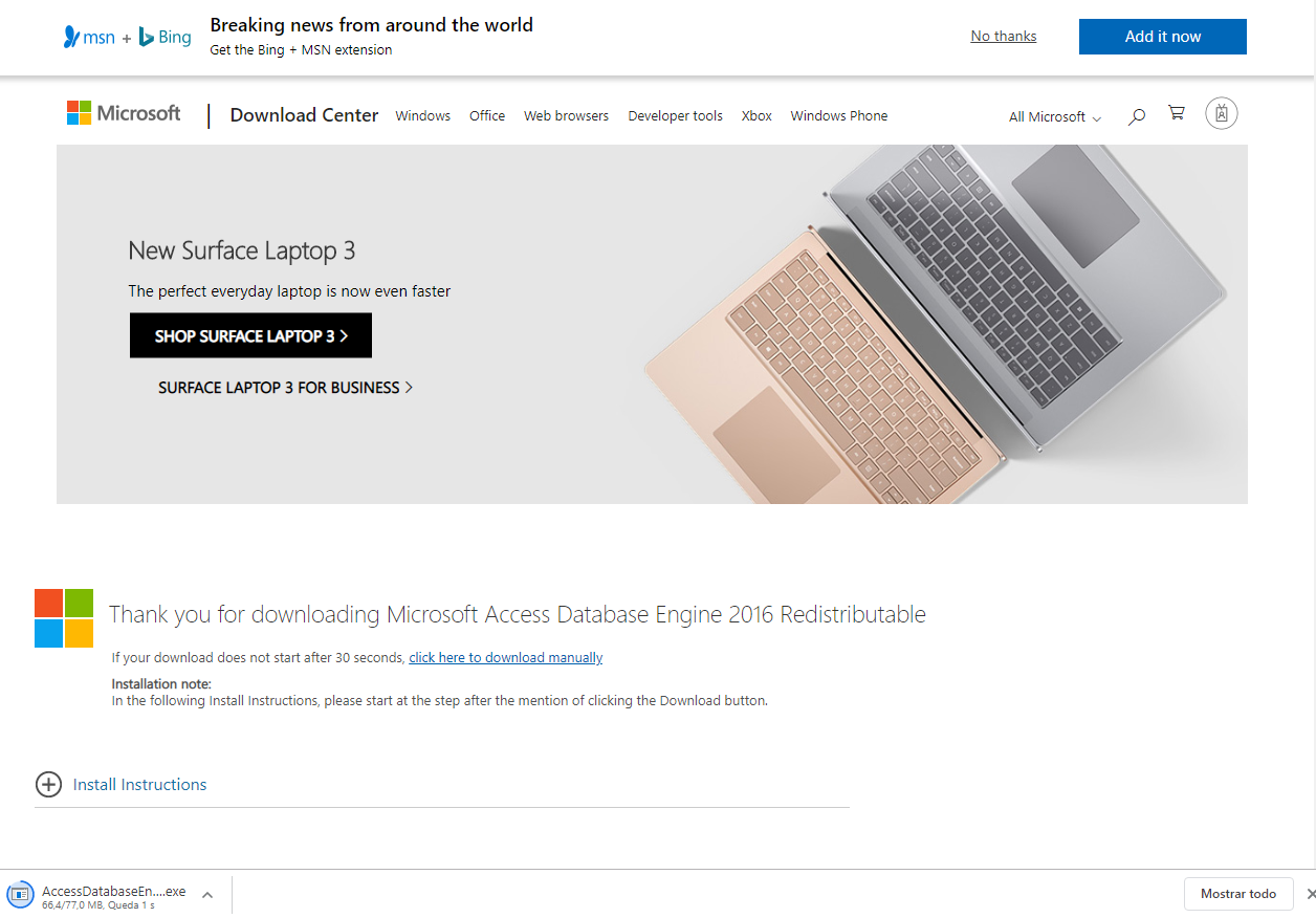

    2. Click on "Download Center" and it will take you to the following window: (attached image)
Note: it will automatically download "AccessDatabaseEngine", but it is better to do it manually to ensure.
  1. You must click on " click here to download manually " and download the 1st File "AccessDatabaseEngine" (attached image)
