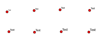

Thanks for the reply which works fine when i type the text in for display but i am obviously missing something when i want to display the text automatically from the field textstring.
var size = $feature.height * 6.66
return `<FNT size='${size}'>$feature.textstring</FNT>`
 Please see the output on the image attached
Andy
return `<FNT size='${size}'>${$feature.textstring}</FNT>`
https://developers.arcgis.com/arcade/guide/template-literals/
