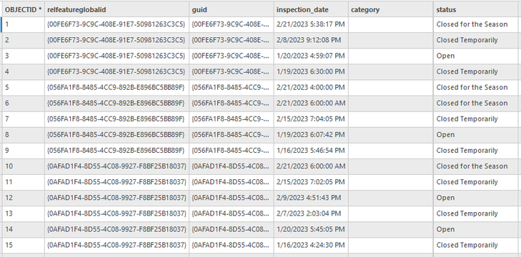

We are looking to find the duration of time something was closed.  We have a status (open/closed) field and a datetime field.  How would I iterate through the related table for each GUID to find the amount of time something was closed?  I am guessing part of this would be to sort by date and GUID and then a DateDiff?
example data for one guid/relfeatureglobalid:

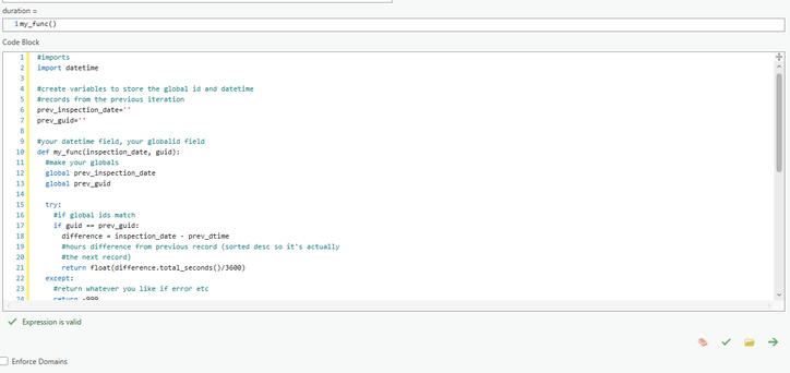

@DavidPike Ok.  Here is what I've got.  Here's the table I'm working with:
Below is the field calculator:

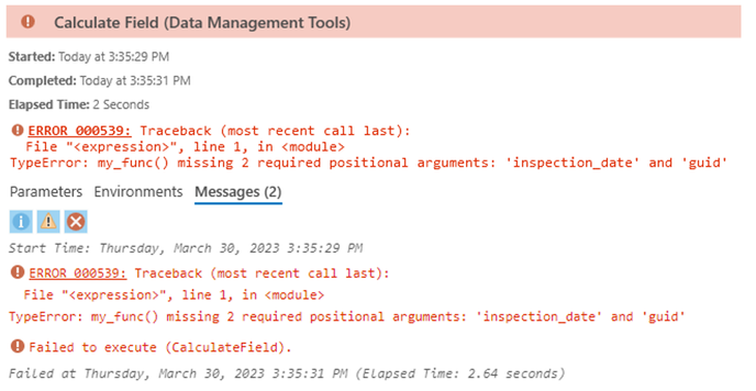

Here is the error I am receiving:
Below is the code in the field calculator:

DavidPike
MVP Notable Contributor
you need to add your 2 arguments into my_func() above the code block - duration = ...
my_func(!inspection_date!, !guid!)
ArmstKP
@DavidPike Oops.  A little oversight on my part.  I ran the code and it worked very well.  A little manual work to remove a few entries, but I can create a filter in the code to accomplish that next time.  I appreciate your help on this very much!

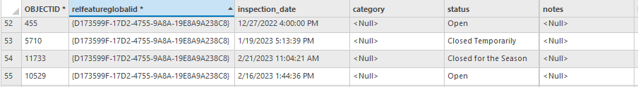

DavidPike
Out of interest what were the entries needing removed?  The most recent entry for each GUID would be set to 0, but additional logic could be added to do a DateDiff with date.now(), although the time period would only really make sense at the time of computation.
ArmstKP
@DavidPike I needed to manually delete some values because sometimes our crews will submit multiple consecutive "open" statuses or multiple consecutive "closed" statuses with different datetimes....
