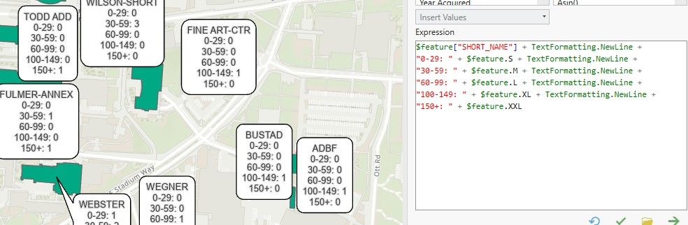

I am trying to use IF statements to help build labels for a layer that shows the number of rooms that are within a certain size category.  There are five different categories for each building.  Each category has its own datafield to store the appropriate number.  I want the labels to only display the size category and amount for results greater than zero.  That way the label isn't filled up with 0's and wasting space.
Below is what I have tried to write but it has an error with the first IF.  Below that is a screenshot of what the labels currently look like.
What I have tried to write which doesn't workWhat I have tried to write which doesn't workCurrent labelsCurrent labels

May be your if statements are failing because the number of rooms is a NUMBER? You are querying if it is a TEXT, e.g. $feature.L <> "0"  should be $feature.L != 0

I gave that a try and still have an "Invalid expression. Error on line 2. Reserved keyword used." message.

You need to show your new code, stating the error message without context is not that much use. Also when you share code use the insert code button (via the 3 dots), a screen shot is no use as the first thing people want to do is copy your code and attempt to replicate the issue, you can't do that with a screenshot!
