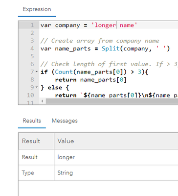

Here's that expression, with a long first word:
And here it is with a short word:

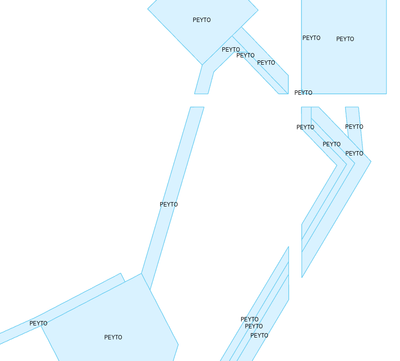

Kristine-DanielaShepherdson
hmmm... PEYTO PEYTO :))) I wish I can meme-it somehow ❤️
