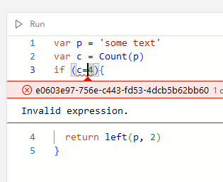

The Arcade editor in Pro is pretty bad. I try to write my expressions in the Arcade Playground and paste them in after. While not perfect, the error checking tools in the online Arcade editors tends to be a lot better and more helpful when you have errors.
Using a similar expression, we see that the error is correctly identified as being an issue with the expression in my condition, not the parentheses.
