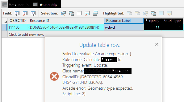

When editing in the Attribute pane and creating / editing features all works as expected.

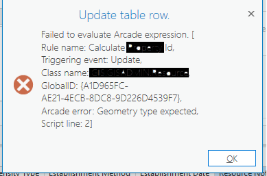

If I RMB on the layer -> Attribute Table and make an edit on the selected row - when I try to commit I get
So I'm assuming the row update creates the $feature differently?
Anyone had this?
Thanks
Fraser
